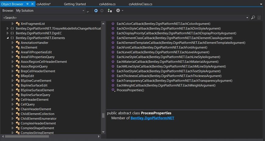

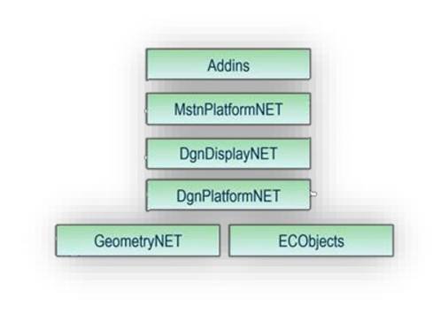

There are many types of elements in MicroStation, we can divide it into graphic elements and non-graphic elements. This part discusses how to use the MicroStation object model to create graphical elements in Add-in. The following figure shows the overall architecture of the CE version Add-ins. Among the objects we use to create graphical elements are mainly DgnPlatformNET.
For more detailed information on the MicroStation object model, refer to the help documentation located in the ...\Bentley\MicroStationCONNECTSDK\doc folder. In addition, when you reference the MicroStation object model in VS, you can also view the entire object model through the object browser in VS, as shown in the following figure. (The object browser in VS is opened by selecting View > Object Browser).
Now that we understand some of the knowledge of graphical elements, let us create some graphical elements in the DGN model through step-by-step operations.
