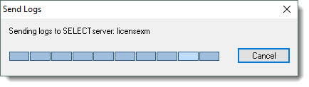

There will be a short wait while you logs are being created and sent, during which you will see this:
 You should note there is no confirmation that your logs have been sent. You can now exit the License Tool.
