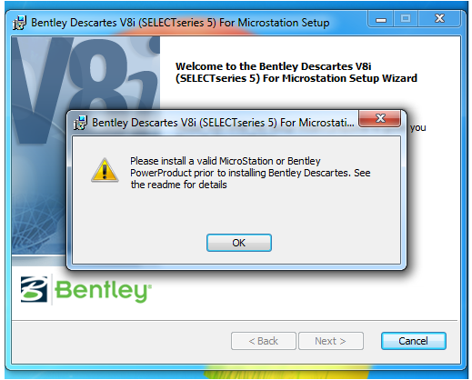

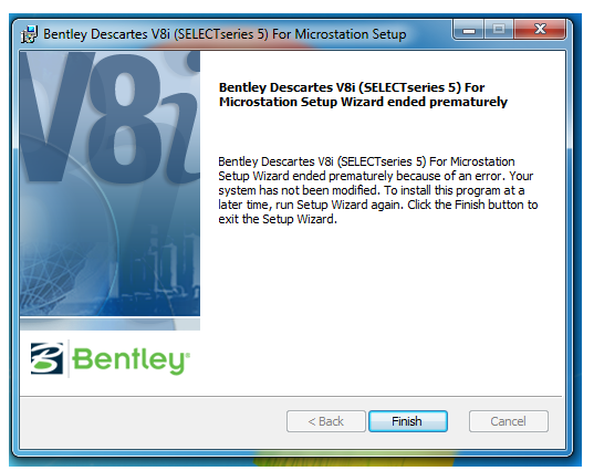

Error or Warning Message
Alert message during installation of Bentley Descartes for MicroStation:
Please install a valid MicroStation or Bentley Powerproduct to install Bentley Descartes. See read me file
Explanation
MicroStation version installed is not certified for Bentley Descartes for Microstation.
How to Avoid
Go to the Fulfillment Center: https://select.bentley.com/FulfillmentCenter/
 Search for Bentley Descartes for MicroStation and check on prerequisites or readme file to find out what MicroStation version needs to be installed.
Note:
Before installing the correct MicroStation version -> uninstall the current version on your system to avoid any problem.
