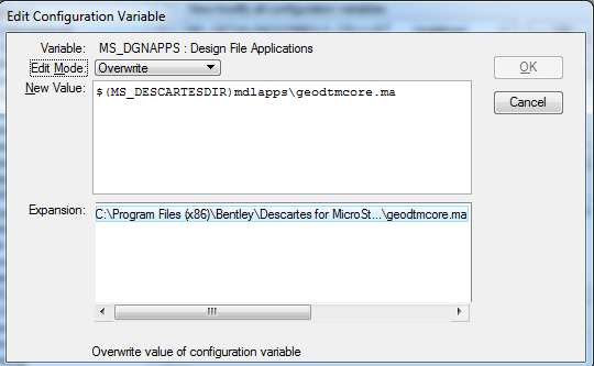

2.)        Workspace > Configuration
3.)        In the center find MS_DGNAPPS

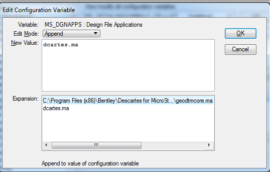

4.)        Select MS_DGNAPPS and select Edit
5.)        Change Edit Mode: to Append
6.)        In the New Value area enter DCARTES.MA
7.)        Select OK to edit out of menu

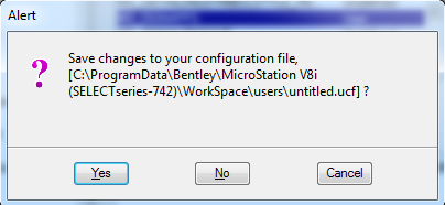

8.)        Select Yes to save change to .UCF file
9.)        Exit MicroStation
When you go back into MicroStation it will start Descartes automatically.

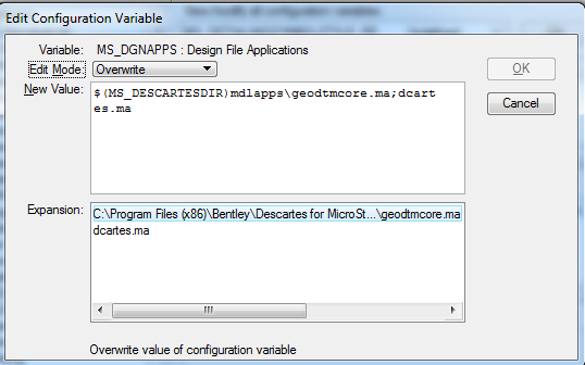

NOTE:   If you use the "="  then it will wipe out any values places in the MS_DGNAPPS variable defined for MicroStation at install time.
