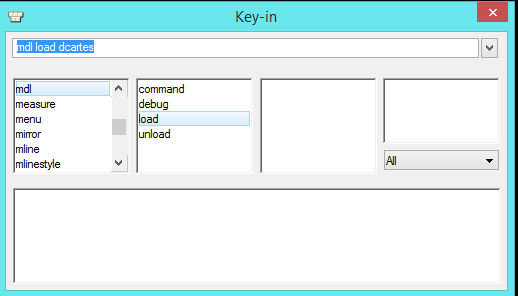

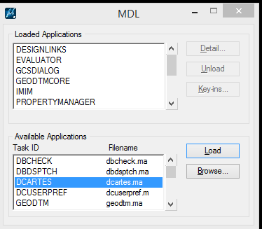

There are 2 ways that a user can start Descartes while they are in MicroStation.
1.)    Utilities > Key-In > MDL LOAD DCARTES
2.)    Utilities > MDL Applications > DCARTES > Load
