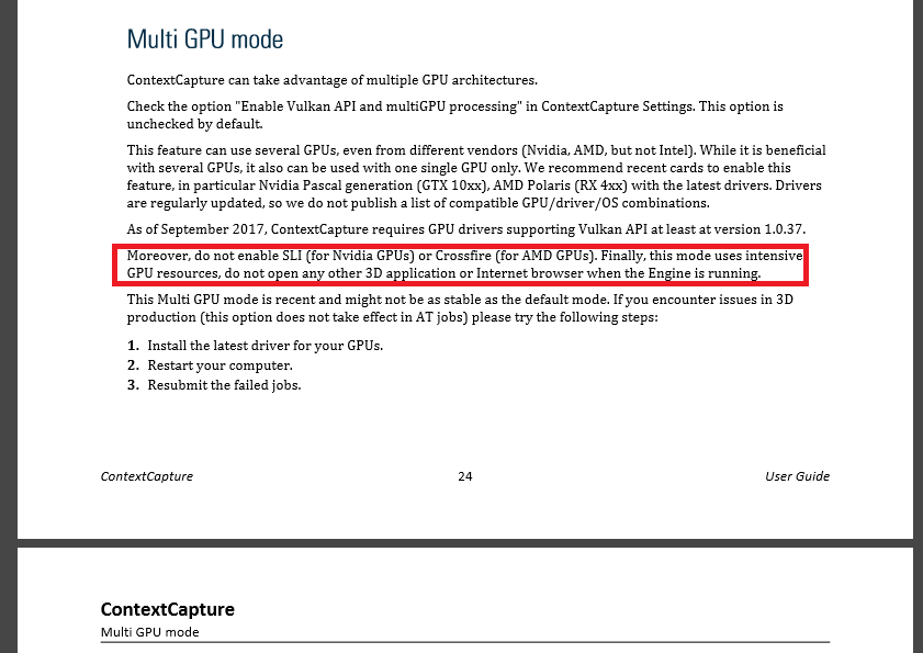

As describe in user manual (p.24), CC can take advantage of multiple graphic cards. User shall be aware that SLI mode should not be use with ContextCapture as a results of slow performances and potentially productions failure.
