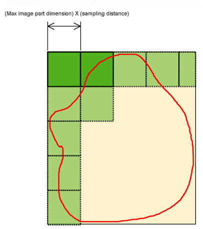

The orthophoto tiling starts from the bottom left corner of the bounding box and increments from left to right (part_1_1, part_1_2, part_1_X, etc.) and bottom to top (part_1_1, Part_2_1, Part_X_1, etc.).
The ortho parts are squared. The size of the tiling depends on two parameters: The maximum image part dimension and the sampling distance.
The sampling distance is the size of a pixel in your orthophotos.
The maximum image part dimension is the number of pixels of your ortho part.
The size, in meters, of your orthophoto part is “Max image part dimension” x “sampling distance”.
For example, with a sampling distance of 5 cm/pixel and a max image part dimension of 4000 pixels, the ortho parts will be 200m x 200m.
Note that the parts at the right and bottom edges of the bounding box are clipped to the bounding box extent.
