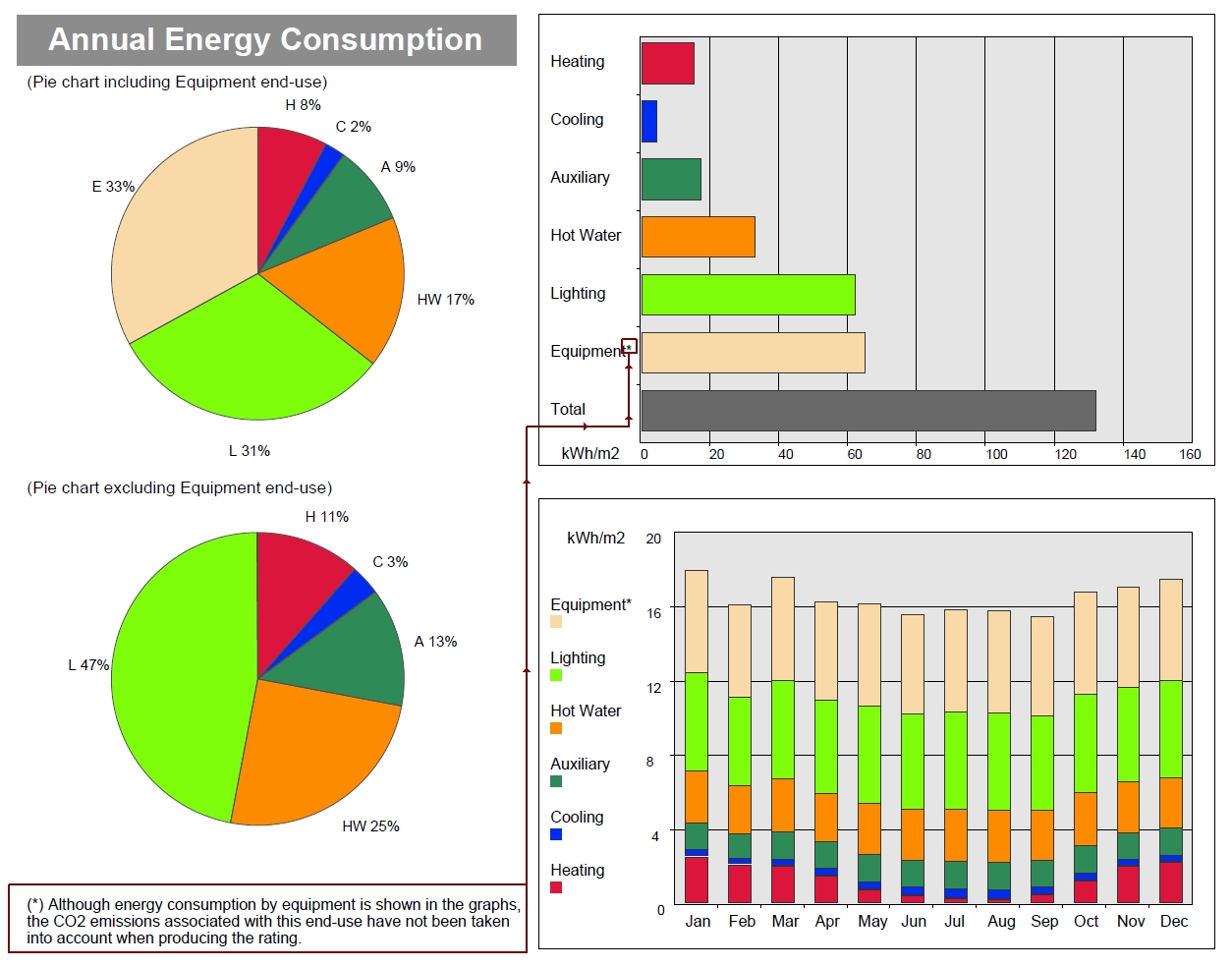

The BRUKL Compliance and Energy reports from the Hevacomp Part L program contain useful information about the sources of energy usage within a building.
Method
The breakdown of the energy consumption within these documents can provide valuable insight into what areas are having the greatest impact on the energy rating. Specifically:
This can highlight what areas should be targeted when looking to reduce energy consumption. These figures are shown in the Energy Consumption by End Use section of the BRUKL Compliance report, and graphs within the Energy Report. These can be seen, side-by-side below:
Important Note
The Total figure in the above reports does not include the energy usage for Equipment. This is in accordance with the SBEM calculation methodology and results required by DCLG. Please see highlighted note below:
