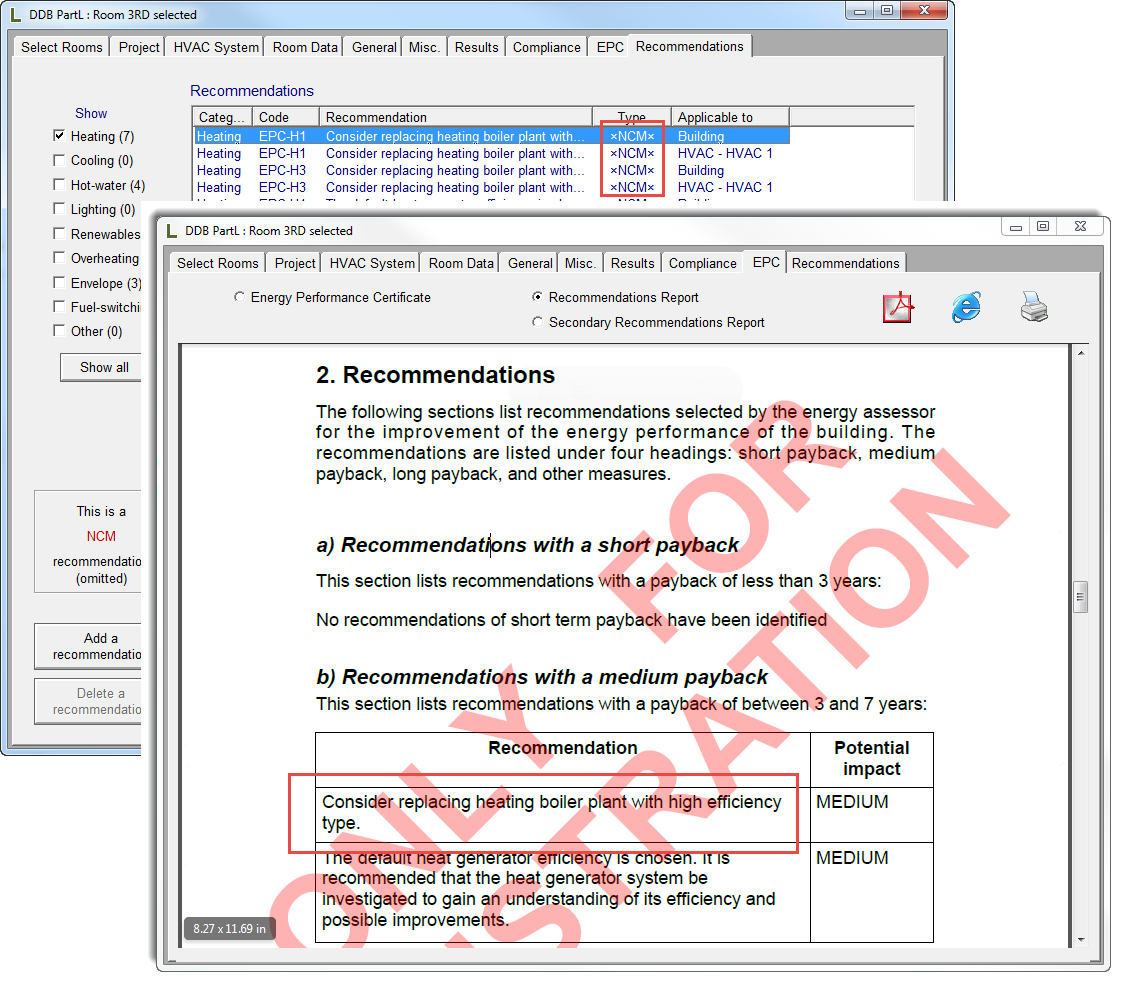

Omitted Recommendations shown in Recommendations Report
 Product(s):Hevacomp
 Version(s):V26
 Environment:N/A
 Area:Design Database
 Subarea:Part L
'Omit Recommendation' selections are not reflected in the Recommendations Report.
To resolve this issue you will need to force a re-calculation as follows:
The software will then regenerate all reports, and apply recommendations settings.
