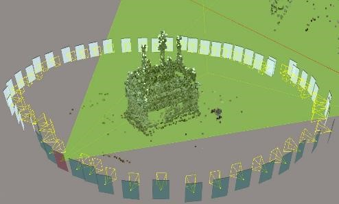

Step 2.   Photo acquisition
  1. Select a highly textured and geometrically complex scene
  2. Acquire photos at 360 deg around the scene
  3. Shoot photos holding the camera in different positions (horizontal / vertical). NB. this only applies if auto-rotation mode is disabled

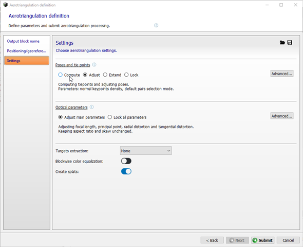

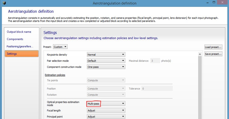

Step 3.   Process your dataset in ContextCapture
  1. Create a new project and import your photos
  2. In the Photogroup tab, select the type of camera being used: perspective / fish-eye
  3. Submit and aerotriangulation. In the aerotriangulation definition keep the settings set at default

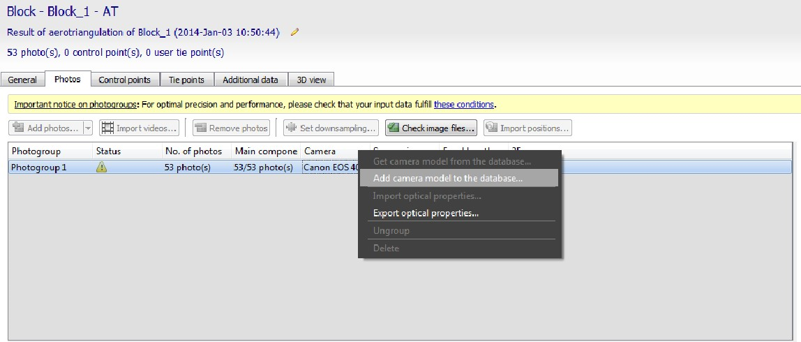

Step 4.   Store your camera calibration in the user database
  1. Go to the Photo tab and right click on the photogroup. Click << add camera to database >>
  2. When processing another project using the same camera, the latest calibration will be used by default. If not you can still browse to it from the camera database by selecting << get camera model from the database >>

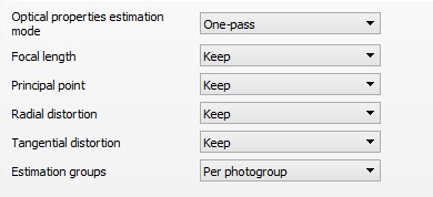

Step 5.   Prevent the software from adjusting the parameters
  1. In specific cases, you may want to prevent the software from adjusting the camera parameters, i.e. If a calibration already exists or has already been imported from the database.
  2. In the aerotriangulation definition settings, under Optical parameters select the option "Lock all parameters".
