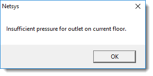

Netsys warning - Insufficient Pressure
 Product(s):Hevacomp
 Version(s):V8i
 Environment:N/A
 Area:Netsys
 Subarea:All

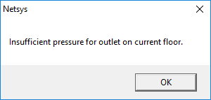

A message stating Insufficient pressure for outlet on current floor is returned upon sizing a system.

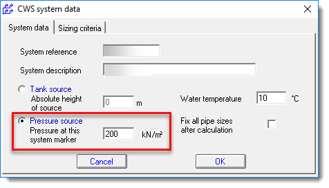

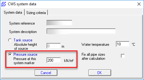

This occurs if your source pressure is not sufficient to meet demand. To resolve this you should increase the Source pressure at your System Marker (Pipes > System Marker > Change System Marker).
Alternatively, you can reduce the pressure in your system by:
