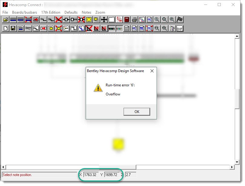

Run Time Error 6 when placing notes
 Product(s):Electrical Design - Connect
 Version(s):V8i (N/A)
 Environment:N/A
 Area:N/A
 Subarea:N/A

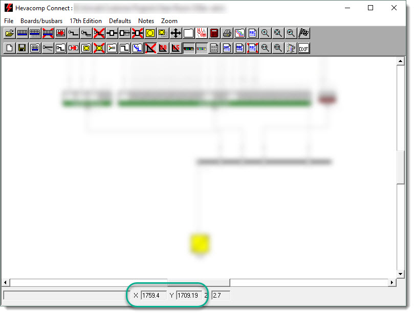

When attempting to place annotation on a Connect schematic, a Run Time Error 6 occurs. This will force the program to exit and any changes since the last project save will be lost.

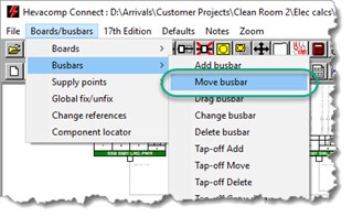

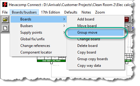

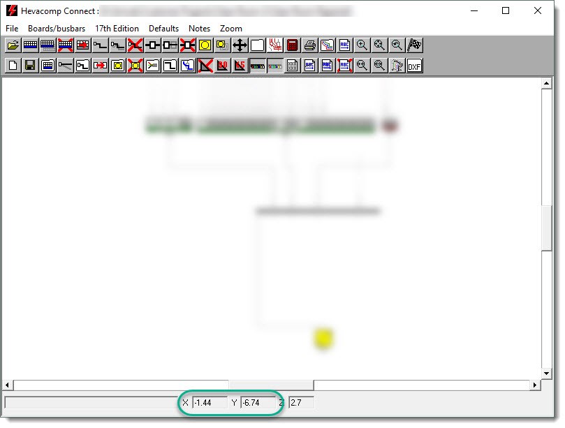

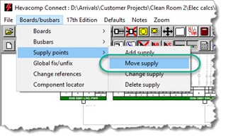

This error is due to extreme figures in the co-ordinate offset for the schematic. You should use the various Move functions to reduce the offset significantly.
