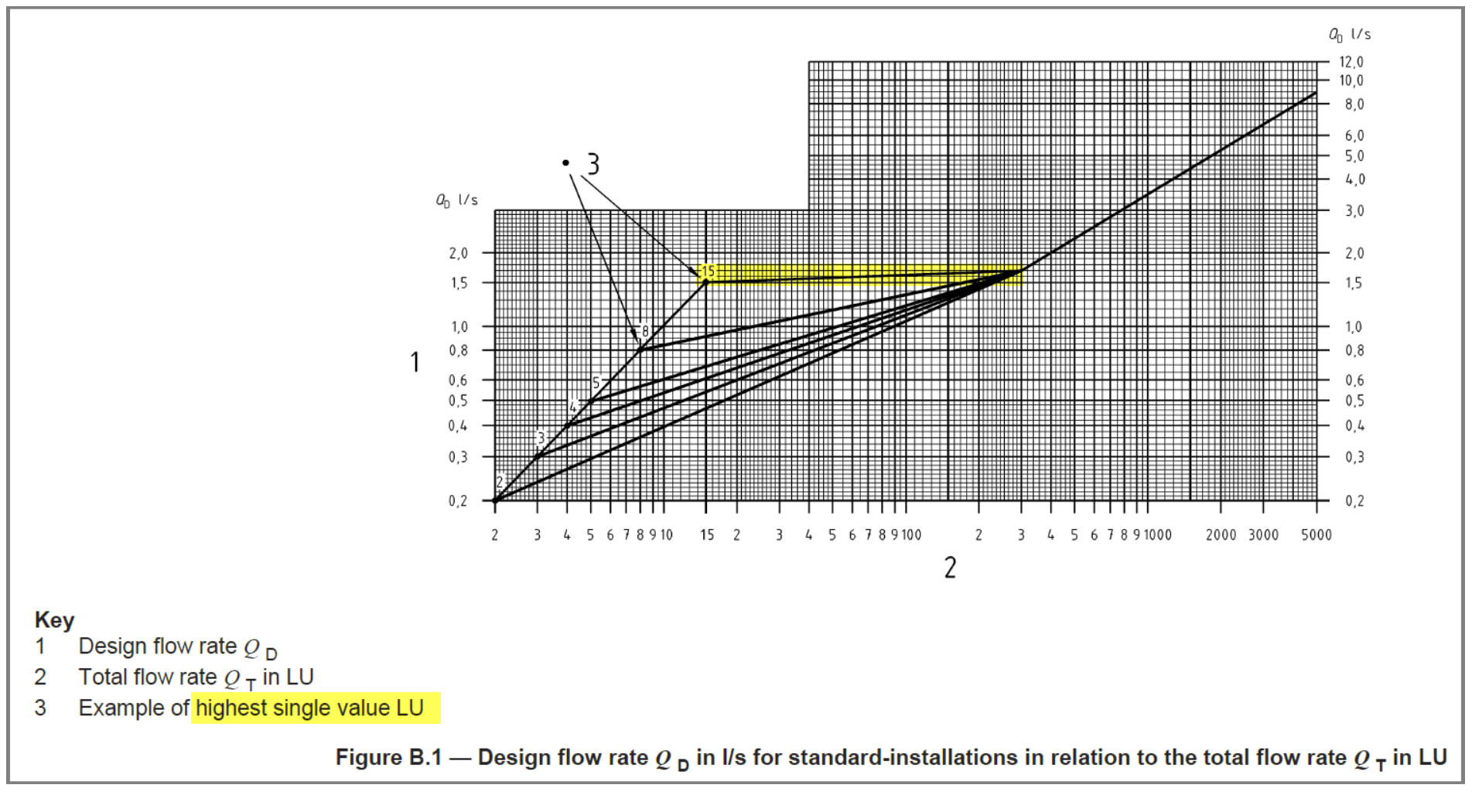

As BS EN 806 is based around the highest single loading unit in a system, care should be taken when choosing the most appropriate approach for your designs.

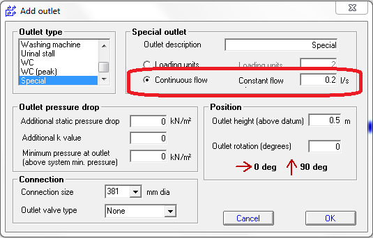

One option would be to create a Netsys HWS project to calculate the demand of your HWS alone.
Then, when modelling your CWS, to take the HWS into account you could take the resulting design flow calculated from the HWS project and enter this into your CWS project as a Special outlet with Continuous Flow, in litres per second.
Please note that this will simply add the additional flow rate into your system, so care should be taken to ensure this approach meets your design requirements.

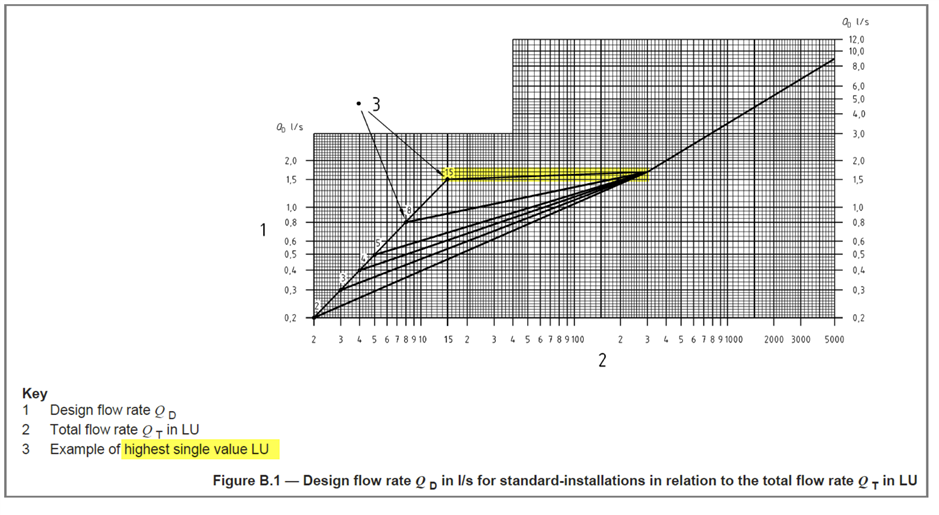

The above principles also apply should you wish to represent a series of outlets (e.g. a whole floor / zone) in one single outlet. To comply with the guidance of BSEN 806 it would be advisable instead to model the complete system, with all individual outlets.
You should not attempt to specify this cumulative demand as a single, large Loading Unit
Doing so is not in accordance with BS EN 806 (detailed here) for two reasons:
