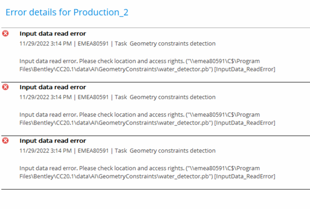

[BUG] Automatic water constraint detection not working in ContextCapture Update 20.1
How to reproduce the issue  :
In ContextCapture Update 20.1  a known bug is affecting the automatic generation of water surface constraints. This bug will result in a failure during the Geometry constraints detection tasks.

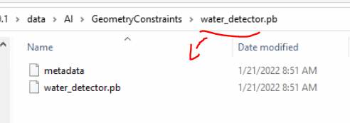

Workaround:
In ContextCapture Update 20.1 , the workaround consists in :
This will be fixed in the next release of ContextCapture.
