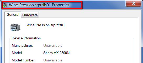

To diagnose if this situation is the cause of your startup or printing problems, determine whether your network printer driver is installed locally or on the server. To do this, select Start Menu   Settings   Printers and Faxes, right-click on the icon of the network printer in question, and select Properties. Look at the title bar of the Properties window—If the driver is installed on the server, then the title bar will say ‘[Printername] on [Servername] Properties’.  Here is an example:

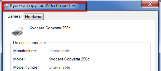

With a locally installed driver for the network printer, it shows just ‘[Printername] Properties’.  Here is an example where the driver is installed locally:
