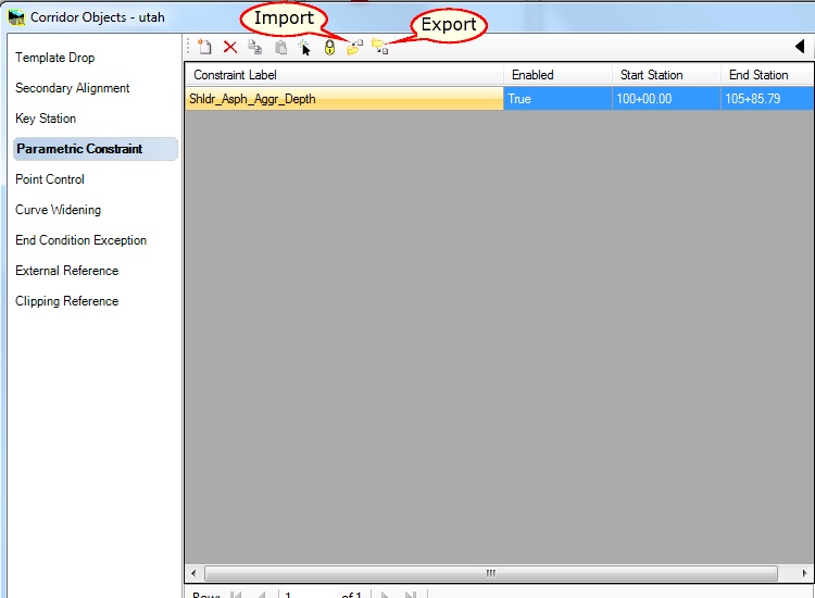

Is it possible to import and/or export parametric constraints in OpenRoads?
Answer:
Parametric constraints can be imported and/or exported from the Parametric Constraints section of Corridor Objects.
![](c58bb72e47798e1088c56642846d434b.iix)
![](998bb32247fd4e10e3378d53636d436f.iix)
