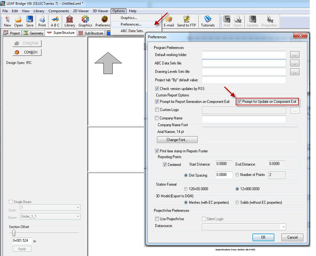

QUESTION: In V14.00.00.19 where can the user find activate or deactivate option to Update the model?
ANSWER:
In the previous versions whenever the user tried to close any of the leap bridge module generally the program prompts a message asking whether to Update the model or not. If the user says YES then the program updates the model and the ABC wizard gets deactivated..
In V14 the user can go to OPTIONS --> PREFERENCES -->  Check the option  "PROMPT FOR UPDATE ON COMPONENT EXIT" .
If the user checks this option then the program will prompt the Update warning message and if the user unchecks it then the program will internally update the model without a warning message.
Please see the attached screenshot for more information.
