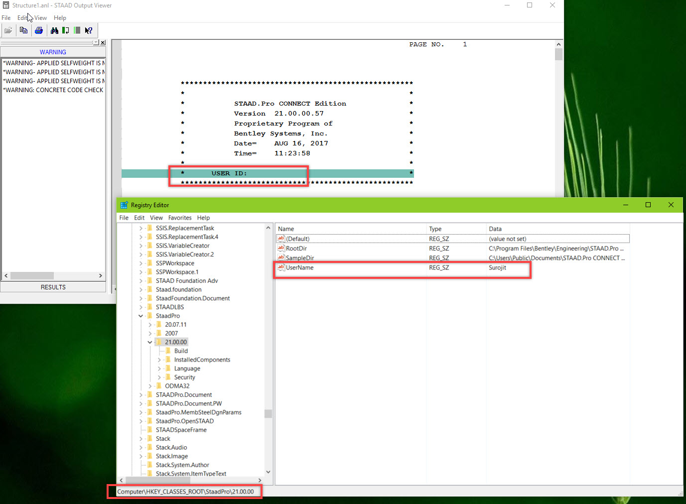

The Output report indicates User ID: with nothing after it.
In STAAD.Pro CE version, the User ID in the output file cannot be changed using the registry key. In previous version of STAAD.Pro, the User ID can be provided using the following registry key (for SS6 version) –
HKEY_CLASSES_ROOT > STAADPro >20.07.11 > UserName.
In current version, though the UserName is specified for 21.00.00 registry key, still it is not displayed in the output file.
This issue has been addressed in STAAD.Pro Connect Edition (version 21.00.01.12 ).
