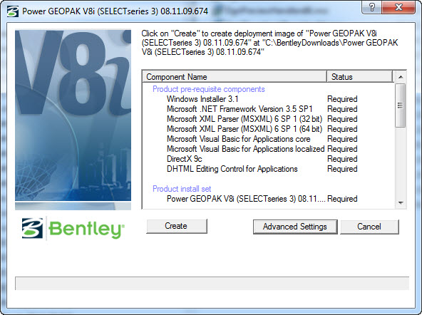

Option 2
For Power GEOPAK, you have the option to create a Deployment Image:

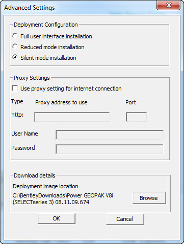

In the options for the deployment image, you can choose to make it a silent install.  Select Advanced Settings.
Toggle on Silent mode Installation
