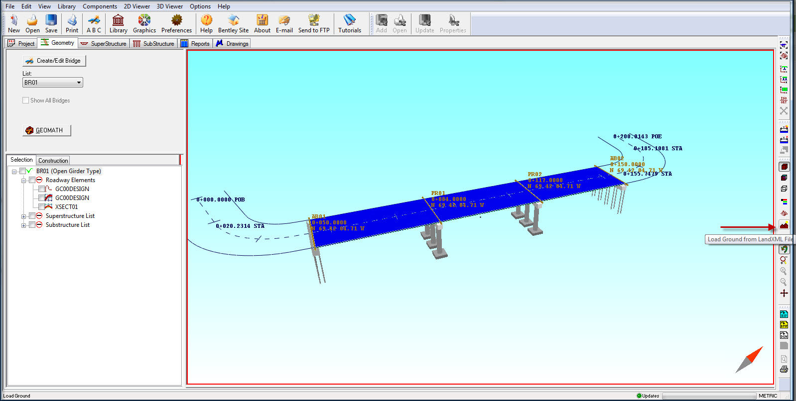

 Once the Bridge is modeled using ABC wizard please go to GEOMTERY TAB.

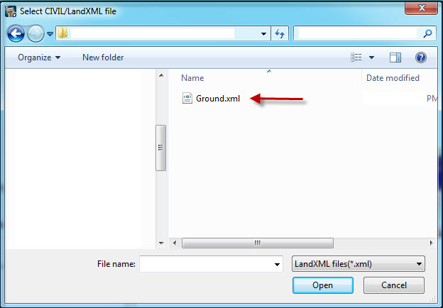

On the right hand side of the 3D view click on GROUND icon which will open "SELECT CIVIL/LandXML file" window.
From this window select the Ground.xml file and click OPEN.

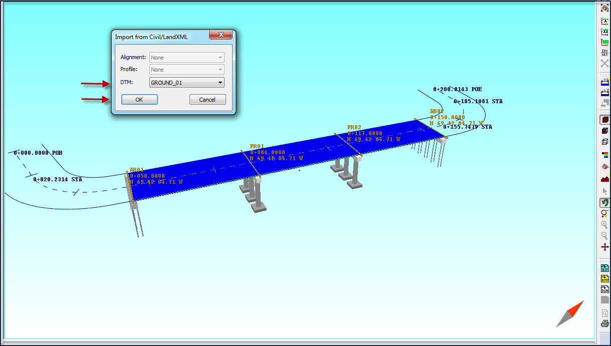

In the new window "Import from Civil/LandXML" please select GROUND_01 and click OK.

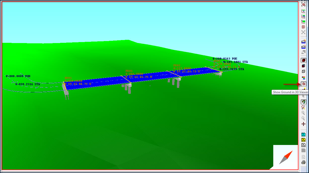

Immediately the program will import the ground data.
Please see the attached screenshot for more information.
