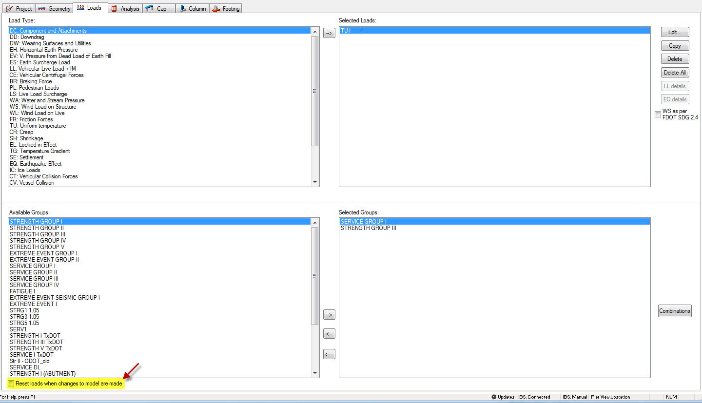

QUESTION: How to reset Loads when changes to model are made ?
ANSWER:
User needs to go to Loads TAB and at the bottom of the screen the user needs to Check the box which says
" Reset Loads when changes to model are made " . Please see the attached screenshot for more information.
