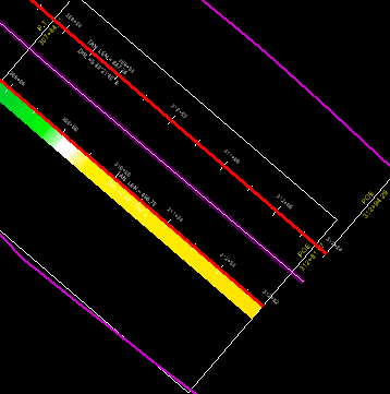

What do the different fill colors mean in OpenRoads superelevation?
Version(s):08.11.09+
Area: Superelevation
Question:
After creating superelevation sections, I notice that the on screen graphics display the superelevation lanes in color-coded fill?  What do the different fill colors mean?
Answer:
Color Shaded Fill Color fills superelevation lanes AFTER calculations are complete. The coloring is hard-coded based on the cross slope:
Based on the side of road, the colors flip. In addition to setting this option, the View Attribute for Fill must also be toggled on.
