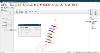

- Click on Alignment from the Alignment Tree.
- Then click on Alignment Tie and a new dialog box will appear on the screen.
- Keep the North and East co-ordinate as it is and copy the information to Notepad.
- Then export the file as 2D or 3D and in the Export Dialog Box Paste those coordinates as X and Y of the global origin and then click “OK”.
- Then user should be able to see the exported 2D or 3D drawing in MicroStation.
- The alignment will be set to the correct X and Y coordinate.
