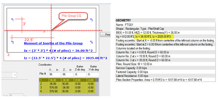

QUESTION: Pile Foundation Design --> How are Ix and Iz values being calculated ?
ANSWER:
Ix and Iz values are basically Moment of Inertia of the Pile Group.
Please see the attached screenshot for more information.
