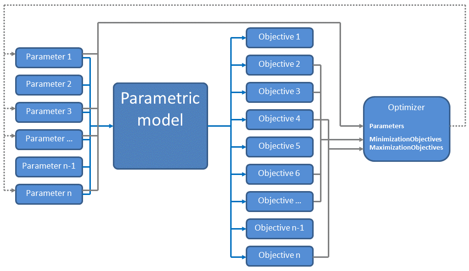

The Optimizer's goal is to minimize and maximize all MinimizationObjectives and MaximizationObjectives, respectively. While this looks like a circular dependency in violation of the GC principle of a directed acyclic graph (DAG), the DAG is actually disrupted in the Optimizer. The Optimizer starts change propagation by updating the set of parameters that were identified to it; changes propagate through the model and update the objective values; those are received by the Optimizer, which does not update anything (of course, once all objectives have been received, the Optimizer will kick off another round of optimization); thus the cycle is disrupted and the principle of the DAG preserved (see figure 1).
Figure 1 also shows that not all parameters that control the model need to be passed to the Optimizer. The Optimizer will only manipulate those parameters that were identified to the Optimizer node. Similarly, not all objective values that are computed need to be used to direct the search of the Optimizer. This allows debugging of dependencies and then exploration of specific aspects of the design to increase the understanding about the parametric model, influences of the parameters, and the behavior of the design in general.
