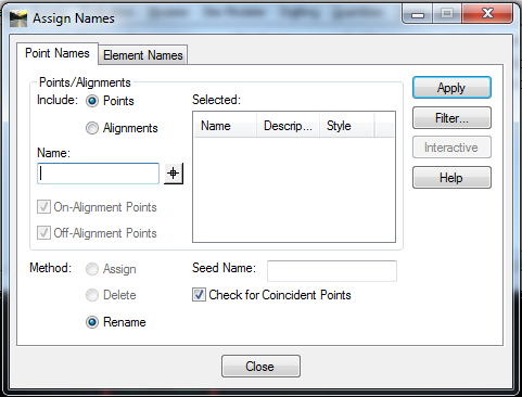

How can I globally rename all my COGO points?
Answer:
Use the Assign Names command (Geometry > Utilities > Assign Names) to assign, reassign, or delete names for geometry points.
