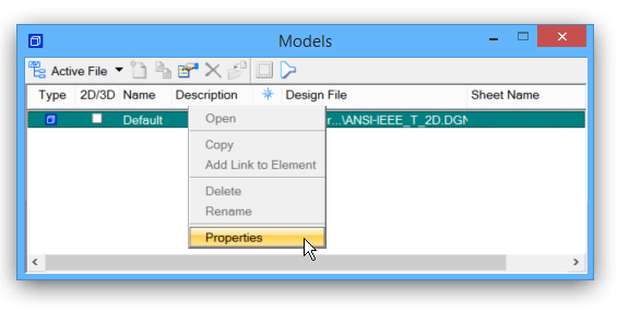

  1. Open the existing drawing, project page, or seed file as the case may be.
  2. Click the Models button on the Primary Tools tool box.
  3. On the resulting Models dialog, right-click the DGN file in the list and select Properties.

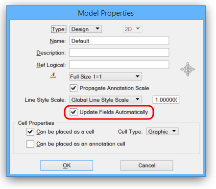

  4. On the resulting Model Properties dialog, set the Update Fields Automatically check box.
  5. Click OK.
  6. Save the file.
