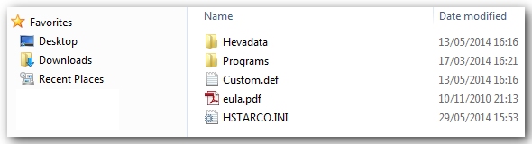

First of all, locate the configuration file from your v25 installation. This will be in the base installation folder - Heva25.
If you examine this folder you should see something like the following:
Copy the Custom.Def file.
Now locate the Hevacomp Data folder for your new Bentley Hevacomp V8i (v26) software.
Copy the Custom.Def file from above into this folder. If asked to overwrite the existing file, select yes. Next time the software is started the Standards and Location configuration will match your v25 installation.
