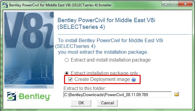

How can I perform a silent install of PowerCivil for <Country>?
Answer:
- Initiate the installation process by running the product executable.
- Select the option to "Create Deployment image".
![](7c010c3297bd8e10afb952800153af43.iix)

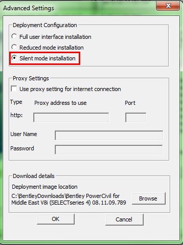

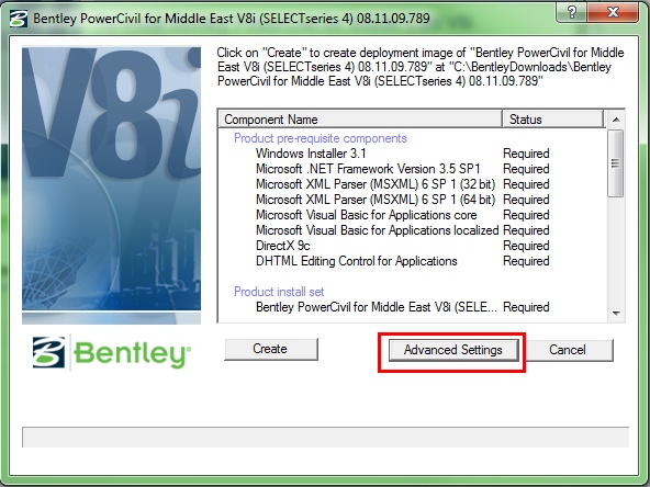

- In the options for the deployment image, you can choose to make it a silent install. Select Advanced Settings.
![](8101483e477d8e1088c56642846d43cd.iix)
- Toggle on "Silent mode installation" and Click OK.
