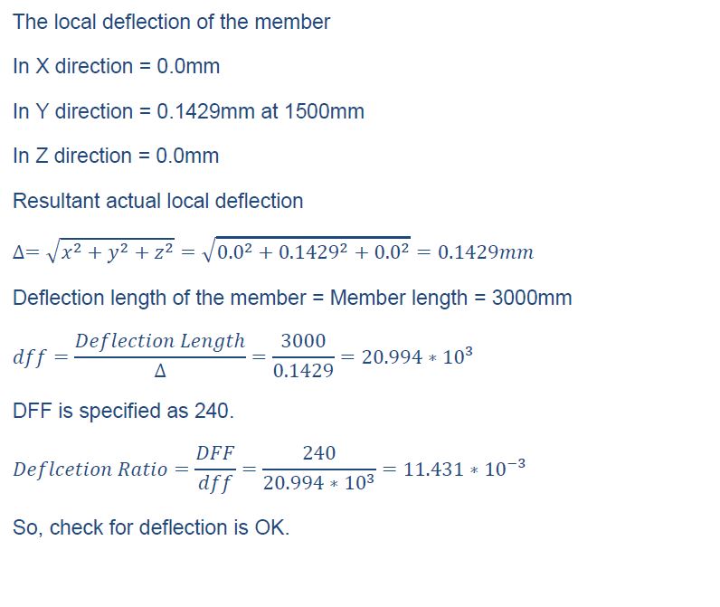

Deflection Check of Laterally Unsupported ISMB Section

Deflection Check
STAAD.Pro Design Output
