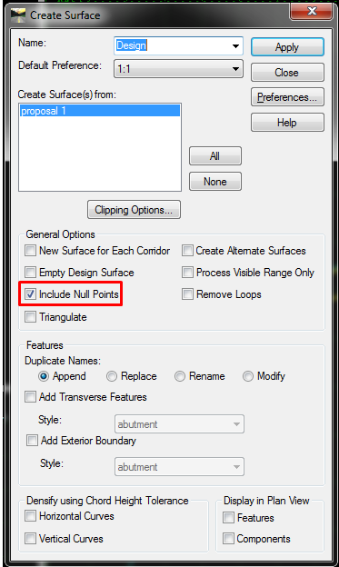

I have created null points in my template.  How can I include these points as features in my design surface?
Answer:
To include null points in your design surface, simply toggle on the "Include Null Points" option in the Create Surface command:
