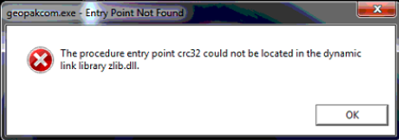

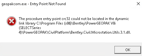

Power GEOPAK 08.11.09.878 failing to install/launch due to “geopakcom.exe – Entry Point Not Found” (images below).  Windows 10.
The solution is to rename the zlib.dll file.  For example:
C:\Windows\SysWOW64\zlib.dll
C:\Windows\SysWOW64\zlib.bak
