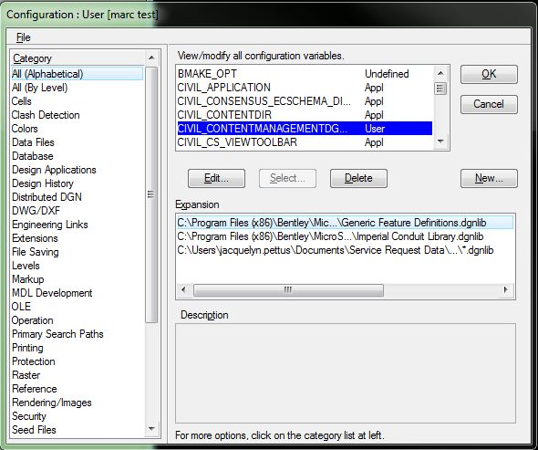

- Go to Workspace>Configuration in the MicroStation menu.
- Locate the variable, CIVIL_CONTENTMANAGEMENTDGNLIBLIST, in the list.
- Select Edit.
![](9d487be21bb14e10dc6db99f034bcb65.iix)

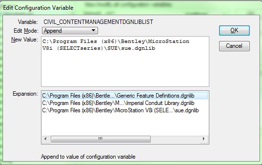

- Change the Edit Mode to "Append" and add the file path to the DGNLIB you wish to add.
![](6d48f7a247398e1088c56642846d4309.iix)

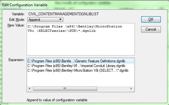

You can also use a wild card to capture all DGNLIBs in the specified folder.
![](0a48b72697398e10afb952800153afd8.iix)
