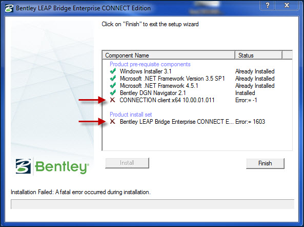

What is a workaround solution when the program shows error while installing Leap Bridge Enterprise Connect Edition?
ANSWER :
Please follow this below mentioned workaround solution to install the program successfully.
1)    Download the installer file ( .exe file) from Bentley Select Server to a folder.
2)    Double click on the .exe file.
3)    Then while installing the program will save .msi files in C: Bentley Downloads\Lbe15010005en           folder.
4)    Please install the Leap Bridge Enterprise.msi and DgnNavigatorControlAx.msi files separately.
5)    Then finally install Setup_CONNECTIONclientx64.exe separately.
Please see the attached screenshot which shows the error message.
