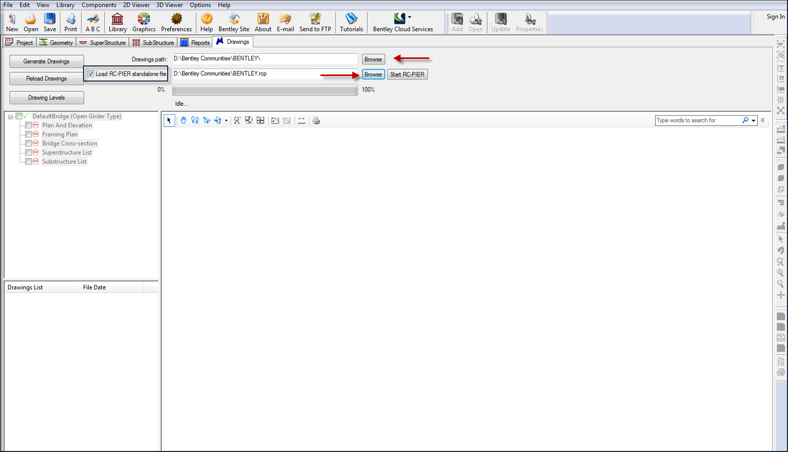

QUESTION: How to generate Substructure Drawings from RCpier Standalone files?
ANSWER:
Once the Substructure structural Elements are designed in RCpier then Save the file as .rcp file and close RCpier.
Open Leap Bridge Enterprise and then go to Drawing TAB and click on BROWSE button right next to Drawings Path option
and then select the folder where in RCpier file is saved.
Check the Box right next to Load RC-PIER Standalone file option and click on  Browse button and select the RCpier file (.rcp).
Then click on GENERATE DRAWINGS button and the program will create Microstation .dgn files under Drawing List.
Please see the attached screenshot for more information.
