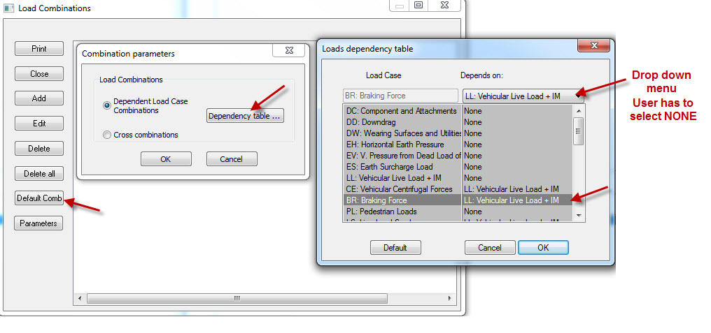

To separate the dependency In the Loads TAB the user needs to click on Combination options --> Parameters --> New window Combined parameters --> Click on Dependent Load case combination option--> Dependency Table button .
In the new window Loads Dependency Table --> Select BR Braking force under load case --> Under "Depends On" heading select NONE from the drop down menu .
Please see the attached screenshot for more information.
