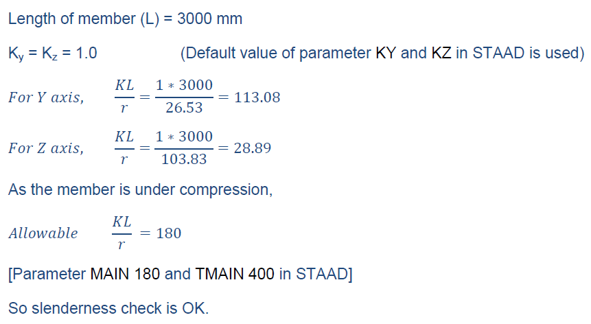

Slenderness Check of Laterally Unsupported ISMB Section

Slenderness Check

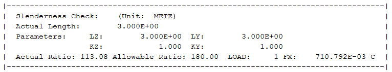

STAAD.Pro Design Output
