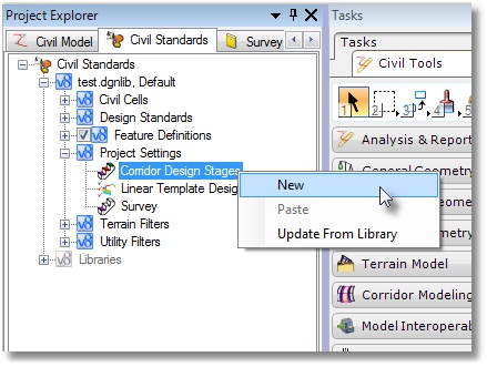

The various design stages used in Corridor Modeling are typically stored in a DGNLIB.  To add a new design stage, open the DGNLIB.  In Project Explorer on the Civil Standards tab, navigate to Project Settings > Corridor Design Stages.  Right-click on Corridor Design Stages and select "New".

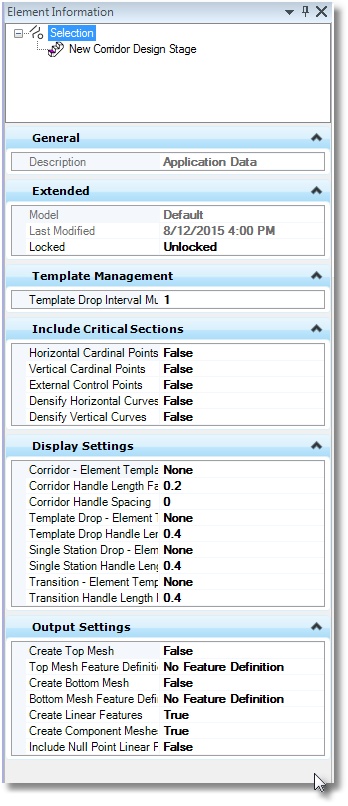

When you highlight your newly created Corridor Design Stage in Project Explorer, the properties will be displayed in Element Information.  In Element Information, you can adjust your settings as desired.
