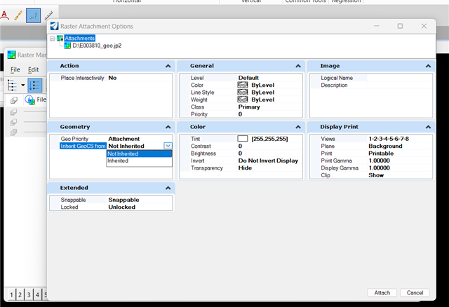

Hopefully someone can help me figure this out. I am attempting to attach georeferenced aerial images (jp2 files) through OpenRoads. The images have a different coordinate system than the drawing file. OpenRoads does not give me the option to change the 'Inherit GeoCS from Model' to Not Inherited, so that the images show up in the correct place with the correct scale. I have tried changing the default attributes, but it still is not attaching them correctly.

The issue is happening as I'm trying to initially attach the aerials to the DGN file, after I have attached a coordinate system.
I see that I am able to change it after the fact, but at that point it does not move/scale the aerial correctly. In SS4, I have the option before I attach them to select 'Not Inherited'.

Double clck the image from Raster Manager in the information box look for the geometry tab at the bottom is the inherit setting.

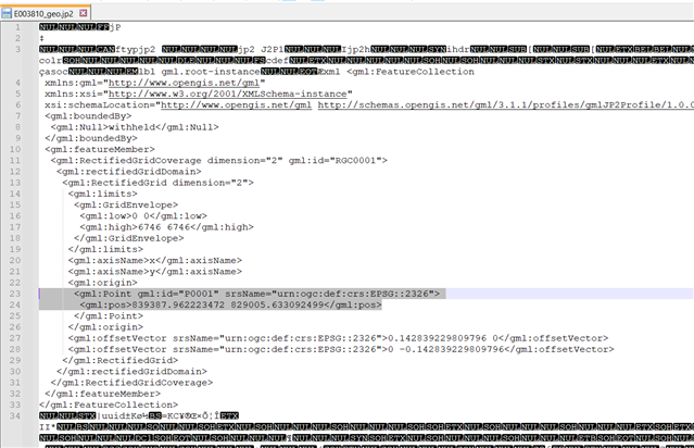

It maybe depend on the header of raster file.
With this header file inside the jp2 file (as example)
In attaching the raster file, an option: "Inherit GeoCS from Model" will be showed.

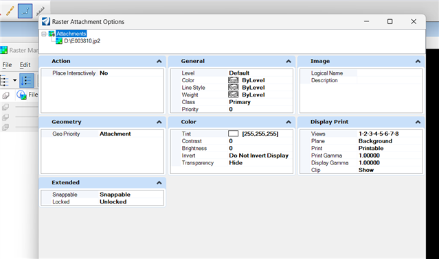

However, with the jp2 file, the header without SRS defined.
In attaching the raster file, NO option for the "Inherit GeoCS from Model"
