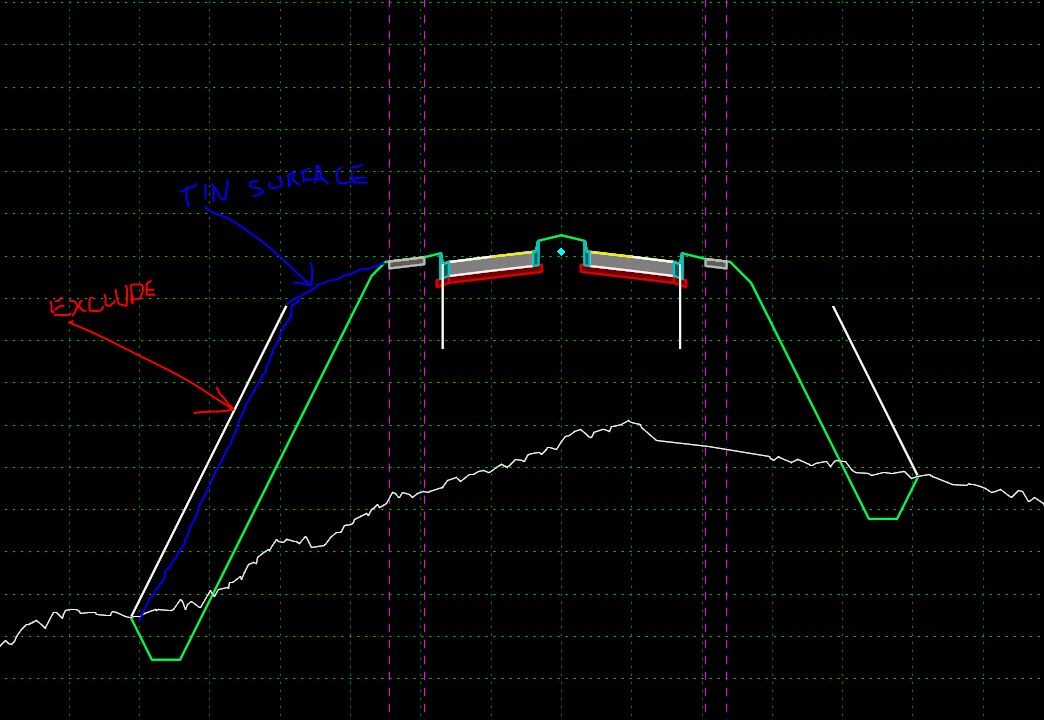

We have a dummy line that we use to set our roadside ditch depths, and despite being labeled as "Exclude from Triangulation", it finds its way into our TIN model.  The green line is the proposed finished grade, the white is excluded, and the blue line is what our TIN model shows.  The green line is a child to the white if that makes any difference.
Thanks,
Andrew
