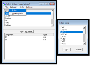

In the settings manager in v8 2004 there is an item under Category to set the scale for that design file.  This would drive the scale of symbols placed in a drawing.
Where can this setting be found OR what has it been changed too in v8i???  Can this be put in to a dgnlib file or added in as a setting??

No its still there but its hidden, (just like old batch plot mdl)  but if you still want to use it  you need to keyin
MDL LOAD SETMGR
then you have to go to the mdl l panel to find your  keyins
I think you want
SETMGR SELECT SETTINGS
then from new dialog
File open / browse
now here to save your self pain copy  your old     .stg file from xm
if not available you'll have to make it  all over again not easy
 then this should work as before and yo may even be able to create F key string ... I did this about 10 years ago for a user who wouldn't embrace change over to V8i unless I could give him the settings manager...  thank God for  Keyins  in the Fkeys..
If you think it worth the effort you could create a pull down menu in a dgnlib.. but the F key was the fastest to run and easy build
Lorys
Thanks for the answer; this works!!
