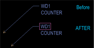

I am placing notes that call out material and below that callout and a note.
My workflow is tedious.
Place note
TYPE IN THE MATERIAL CALLOUT WITH A  TEXTSYLE THAT HAS A BOX AROUND THE MATERIAL CALLOUT
THEN FOR THE LINES BELOW, I SELECT A NEW STYLE WITHOUT THE BOX.
I would like to automate this
I thought a good way would be
1. place all notes without the box
2. Select all notes
3. find all the text WD1 and replace the text-style for only WD1
anyway I could do this? Batch check text style
what would be nice is to have a list of common callouts that would be changed to have the text-style changed

Simple solution is to place one Note with correct format, copy it, edit.
That could be done with a custom program, but not with plain MicroStation tools. I can't think of a way in Plain MicroStation to select only a part of a text node (outside of the editor) - Select by Elements can filter by a string but it selects the entire element. And that only works for Text elements and Text Nodes. I don't think it works on Notes. Find (of Find & Replace Text) can find the string, but it is not a selection tool. And then there's the changing text style of only part of the note without using the text editor, which I don't think can be done without some programming magic.

There are no native tools that can do what you are asking (find part of a note and change style on only those characters). You would have to create something custom, and I think it could be a rather complex tool due to the inflexibility of Note elements.
The closest I can think of would be a manual process of placing all the notes with one style, using Find (of Find/replace text) to work through your drawing to find the string you want to change, and manually editing the text to change the style of that string. But that's nothing you could do with a batch process - it would be one element at a time.
