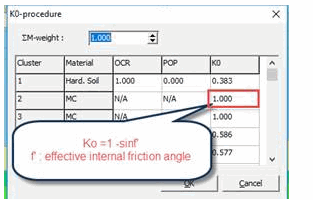

Hi everybody,

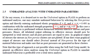

I’m studying the undrained analysis with undrained parameters as the picture below (I got it from your manual of Plaxis ver 8.5).

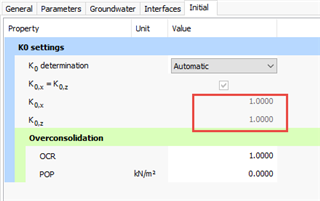

The input parameter of the friction angle affected to static lateral earth pressure coefficient Ko = 1. This leads to sigma’y = sigma’x, my question is whether modification Ko= 1 – sinf’ instead Ko = 1 in the generation of initial stress of soil need or not? Pls follow my illustration as below
Besides, I’d also like to ask you about this modification of Ko =1 – sinf’ instead Ko = 1 in the method of undrained B, C of Plaxis 2D ver 2017 need or not?
