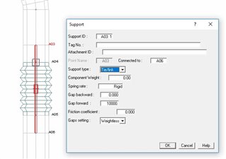

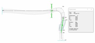

Flexible joint with tie rod - Tie/Link Support does not function as expected
by
Reza Kharrazi
Created (Edited ) in AutoPIPE Forum
Tie/Link still elongate under pressure thrust exerted by expansion joint despite restricting the backward gap to 0.
I faced/noticed this issue while working on a project and decided to replicate the example "Tie rods modeled as a single two-point support" in AutoPIPE to double check based on a benchmark. The defined Tie/Link in the example elongates despite the fact that I have specified a rigid spring rate for the support and 0 gap backward.
image        image
communities.bentley.com/.../Tie-rods-modeled-as-a-single-two_2D00_point-support.DAT
