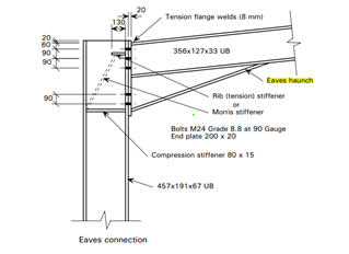

Hello!
I would like to hear your recomendations how to decrease utilization factor in bracing and rafters without unnecessary bigger sections.
Maybe I am missing something in my model, some fatal error that messes with everithing.
Is there a way to put plate stiffeners on top or bottom beam flanges?
How can I add eaves or appex haunch to the model just like in picture bellow?
