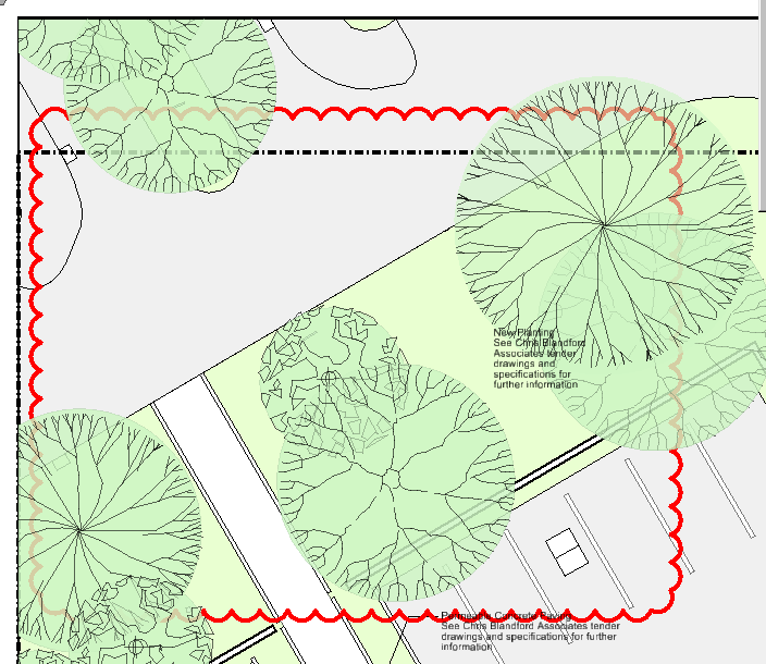

Hi All,
In MicroStation V8i Ver 459 using 2d seed and working only in 2D, I have the following problem with graphic display order:-
The Red cloud shown below is in the active file and the trees are in a reference, using update sequence in the reference manager the active file is set to the bottom of the list which should be top most in the display order but the trees are still masking the cloud.
Everything is drawn at 0 priority in both files, there are no display overrides set for priority in levels or references or elements. I have tried using bring to front on the active file, if I apply a plus priority to the cloud it fixes the issue but we try to avoid using priorities to avoid this very scenario affecting the sequencing.
I welcome any suggestions why this might be happening.
