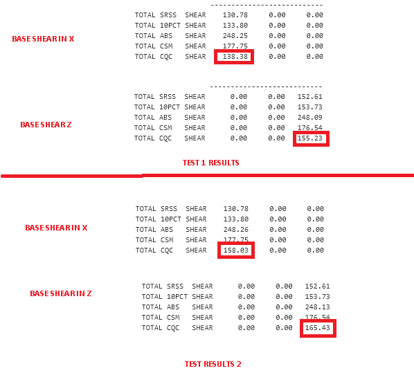

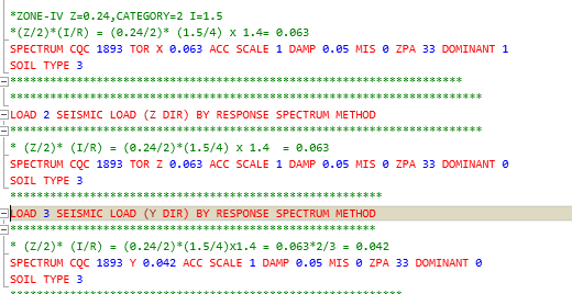

I have made a  two  test model for the response spectrum analysis which is attached herewith, i have two questions,
1) TEST MODEL 1:  When I have specified the Seismic response spectrum (IS 1893)  as per below where damping is 2% for steel
2) When I have given the Seismic response spectrum (IS 1893)  as per below where damping is 5% for & multiply by coefficient by 1.4 ( for 2% steel as per code)
Question 1: Then Why there is difference between CQC base shear ? & all others base shear matching
I have checked the Time period / participating factors /shear  its same for both model but difference in base shear so its reflects in unity ratio  for steel design .
Question 2 : I have prepared Portal frame applied loads & do the same procedure as per above then Base shear /unity ratio is exactly matching.
Anyone getting same issues ?
