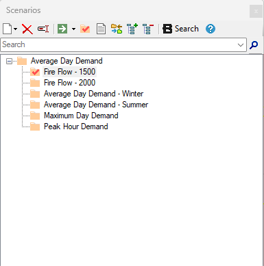

I have set different Scenarios in WaterCAD for different Demand Patter Conditions, such as Average Day Demand, Summer Demand, Peak Day, Peak Hour, etc.:

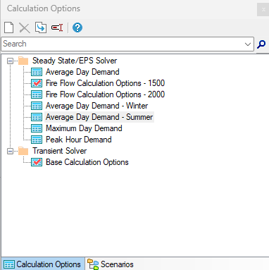

I applied multipliers for these different scenarios on the Calculation Options as shown in Option 2 of this tutorial: Modeling scenarios with different demand conditions
I also set two different alternatives for Automated Fire Flow, one for 1,500 gpm and one for 2,000 gpm:
These two alternatives are run adding to the baseline demand for the Average Day Demand conditions, but I would like to run the Automated Fire Flow with all the other different Demand Conditions I set in my model.

If you want to run a fire flow analysis on each of your demand alternatives (or each calculation option using demand adjustments if you are using that method), you will need to create a new scenario for each of the cases. Basically, for each of the different demands, you would need a scenario for the fire flow analysis.
