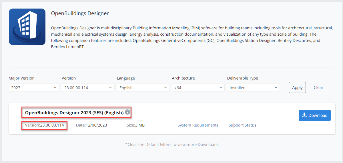

To download, visit the Software Centre and select the required version ( 23.00.00.114), as below:
