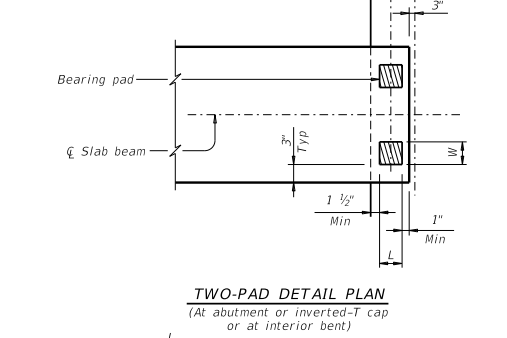

Is there a way to place two bearing pads per beam location as shown below?
Accepted Solution
(1) Move to go Beam Layout definition.
(2) Select the check box for Advanced Bearing Definition
(3) Enter Desired numbers of bearing in to the input of Number Required
(3) Specify the spacing and offsets
(4) Select the Save button
(5) Place the bearing and then OpenBridge will place the bearings that be based on above inputs.
